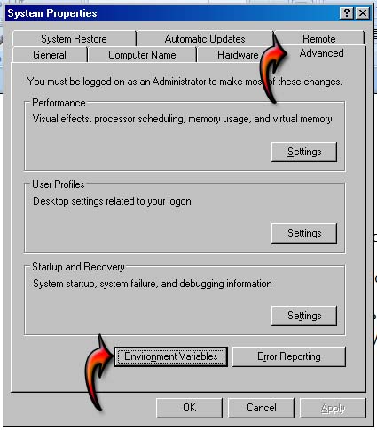

There is a simple work around that worked on the guy playing the Counter Strike and may possibly work on you too. We’ll just need to make some changes on the original method since you both have different programs to refer to. Click Start, Control Panel, Performance and Maintenance, System. Select Advanced tab. In the lower part, click Environment Variables. See image.
In System Variables, scroll down and find “Vproject”, select it, and hit Edit. Change the string to without quotes “C:Program Files (x86)Steamsteamapps”. Click OK all through out then try again. This should fix the problem.
