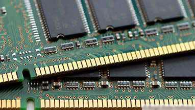

When data is being read, the bits of data run back on a separate “data line”. To describe a RAM chip, a 256Kx16 notation means 256 thousand columns of boxes or cells standing 16 rows deep. Below is an image of a typical random access memory showing the etched electrical lines going around it.
