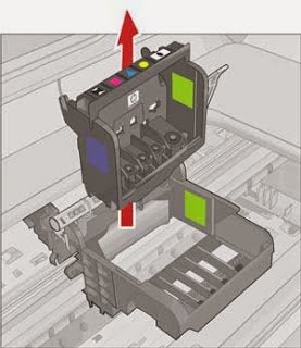

This error is caused by mainly two reasons, which are either the ink cartridges are not properly installed in the printer, or the ink levels in the cartridge are not sufficient enough to carry out the print. Thus you can remove the error by re-installing the cartridge or refilling them. Try both things to see if the error is gone or not.
If not, then clean the printer and re-install it on the device. Make sure you remove the power cable and disconnect it from the system before cleaning. If after cleaning also the error is there, then try removing the printer head and placing it back again. Re-start the printer. After trying all these things, the problems continue then go to a hardware expert or a service center.
