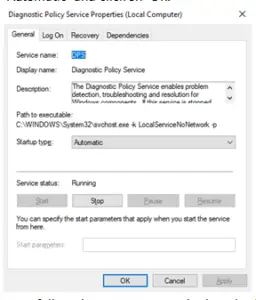

Click on the start menu and type ‘Services’ in the search bar. Click on ‘Services’ to open it.
Now, you will see a list of services. First, you need to search for ‘Diagnostic Policy Service,’ right-click on ‘Diagnostic Policy Service,’ and click on ‘Properties.’ Select the ‘Start-up’ type as ‘Automatic’ and click on ‘OK.’
Now, follow the same steps and select the ‘Start-up’ types as Manual for ‘Diagnostic Service Host’ and ‘Diagnostic System Host.’ Once done, try restarting your computer and check if the error persists.
