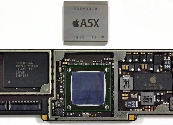

According to Raymond Soneira, who is the president of Display mate technology, the heat issues in iPad is mainly due to the LED
– There are double number of LEDs, and the heat generated by all these LEDs cause problems at full brightness
– The amount of power needed is twice. As the new iPad has more pixels more brightness is needed for a clear display.
So obviously more power is needed which adds to the heat
– In order to provide the power requirements, the battery has to deliver more, hence battery also gets warmer
The A5X chip packing quad-core graphics  is warmer as its speed and size is greater, which also contributes to the heat. However, we cannot point this as the main cause for the heat issues. The main issue would be related to the LED display.
