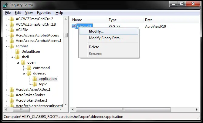

You might need to check the Acrobat registry entries. To do this, do the following:
1. Open the Windows registry editor.
A. Click Start.
B. Type "regedit" then press Enter.
2. Navigate the following through the tree list view from the left pane:
ComputerHKEY_CLASSES_ROOTacrobatshellopenddeexecapplication

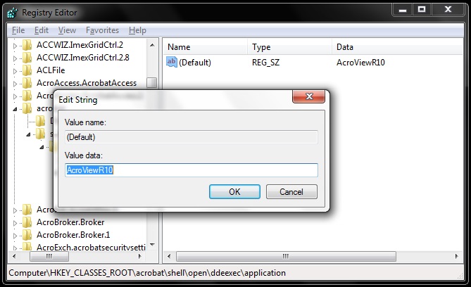

3. Right-click the value from right side of the window and click Modify.

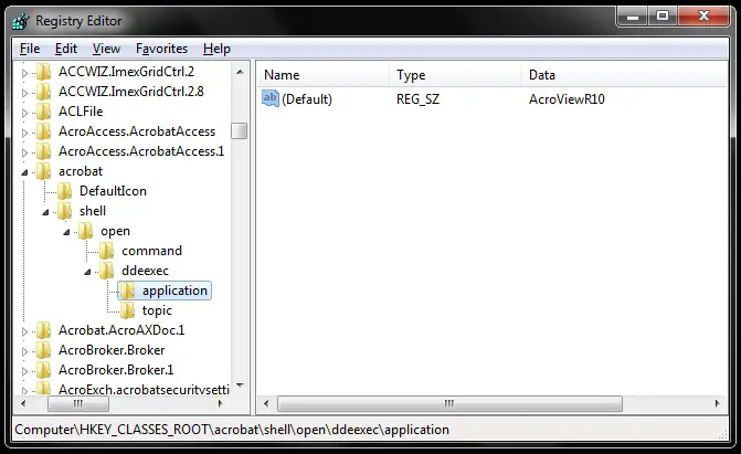

4. Change the value of the key from "AcroviewA10" to "AcroviewR10".
5. Click OK. Close the registry editor.
Check if the issue is already solved.
