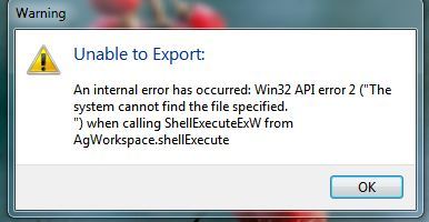

Failed to export from Lightroom 4.1
I am wondering whether someone can assist in solving the error I have presented below. It happens when I am exporting from Lightroom 4.1.
Warning
An internal error has occurred: Win32 API error 2 (“The system cannot find the file specified.”) when calling ShellExecutiveExW from AgWWorkspace.shellExecute
Best Answer by Nichols Fryman
Answered By 1065 points N/A #190025
Simply go to the bottom of the Export Dialog box and then under the Post Processing section, look for the pop-up called After Export. It is presently blank. Modify it to Do Nothing to fix your issue.
Answered By 15 points N/A #190024
Hi Stephen,
This error occurs because the export file is corrupted.
There can be two solutions for the error:
Solution 1:
1) Check for the ‘Post-Processing’ section of your dialog
2) In the dropdown of ‘After Export’ make sure you have a valid entry selected
3) Click ‘OK’
Solution 2:
1) In the Exports screen, remove the setting
2) Add the setting with a different name
3) Error message is displayed.Image exports successfully
