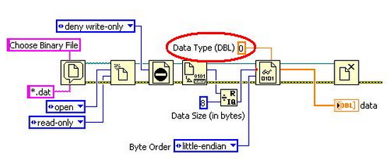

Here are some reasons for this error:
Either
Same data type must be input into the read from binary file VI. Input data type must be matching what you expect to read.
Wire only one scalar double to data type
Wire only one scalar double to data type, if you are reading an array of doubles (1D or 2D). Array of doubles (1D) –return if Read from Binary File VI.
Or
Use of Datalog Vl which was designed for, cluster of multiple data types with the Read from Binary File VI. These VI still save the data as binary data.
Or
You must look previous copy of the binary file before you modified the binary file with a text editor.
