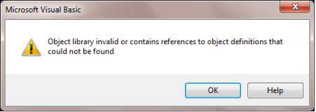

I received an error when I run the macro with SolidWorks 2012 SP1. This works with SolidWorks 2011 SP4. How can I fix this?
Microsoft Visual Basic
Object library invalid or contains references to object definitions that could not be found

Hi Miley!  One possibility that why you’re having that error is because of a workflow that causes some item missing or having incorrect position in the FeatureManager. I believe a hotfix has been created for this issue but i do strongly suggested to upgrade to SP2 instead. Have you tried upgrading to SP2? If you weren’t able to upgrade yet, how about you export and import your old macros to a blank macro and try running it again. If this doesn’t work then i suggest you go ahead and upgrade.
