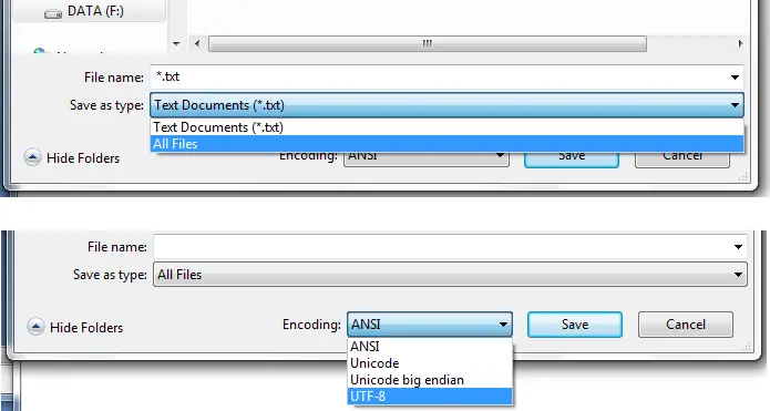

3. I don’t know which editor you’re using for coding your script, so I assume you are using Notepad (you use Windows XP). In this case, be sure to save filename.scm (you did) and select “All Files” in “Save as type” box. This prevents Microsoft’s Notepad from adding the .txt extension to the file name. And also be sure to select “UTF-8” character set as encoding ( as shows in the figure below).
