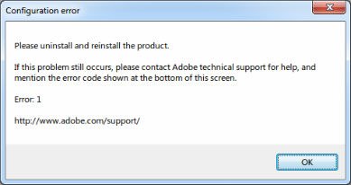

I Installed Photoshop CS6 but when i open it , I receive this error:
Please uninstall and re-install the product. If this problem still occurs, please contact adobe technical support for help, and mention the error code shown at the bottom of this screen. Error: 1
Configuration error
Please uninstall and reinstall the product.
If this problem still occurs, please contact Adobe technical support for help, and
Error: 1
https://helpx.adobe.com/support.html
                                                                                              OK
I tried to re-install it many times, but the result is still the same.
Anyone got solution for this?
