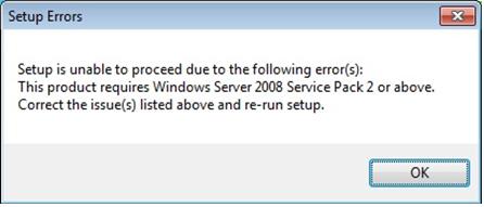

After downloading it, now I am facing a problem. I wanted to install it by running the .exe file but whenever I try to do it, an error window pops up which is shown below:
Error:
Setup is unable to proceed due to the following error(s): This product requires Windows Server 2008 Service Pack 2 or above.Correct the issue(s) listed above and re-run setup.

Setup.exe the executable for the installation process was running in compatibility mode for some reason.
Try this:
Right click on the setup.exe file.
Click on Properties.
Click on the Compatibility tab.
uncheck the option for Run this program in compatibility mode
Click Apply, and then click OK.
Double click on the program.
Hope this helps!

After checking the compatibility settings, you can take the following steps if the error still occurs:
  1. Install the Sharepoint 2010 Pre-requisites as shown below
  2. Pre-requisites installed successfully
  3. Start the Foundation installation
  4. Run the Sharepoint Configuration Wizard
  5. All the tasks should have been completed successfully
Hope this was helpful to you.
