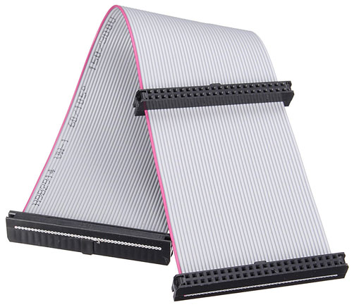

Sometimes the IDE cables can be the problem. Check your IDE cables if it's working good. Maybe It doesn't plug correctly.

This is addressed on IDE ATA drives, not SATA drives. For those of you having this problem, here's your answer. Make sure that the black jumper on the back of your main hard drive is set to "MA" (MASTER) as abbreviated according to the schematics shown on top of your hard drive. (On the sticker at the bottom.) Any other drives that you have such as your CD-ROM, DVD-ROM must be placed as "SL" (SLAVE) as abbreviated on the back of them. (These abbreviated lettering is stamped in the metal or plastic part in the back, it can be hard to see, use a flashlight to get a good look at it.

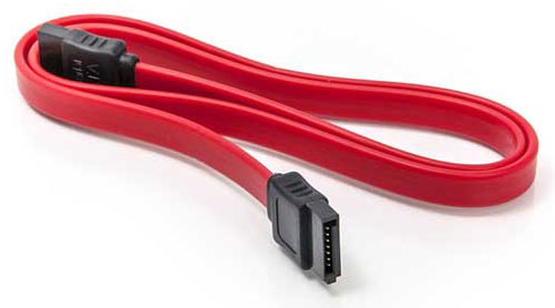

The cause of the problem here is probably the connection of the hard drive that gotten loose. Your hard drive is connected to the computer or to the motherboard via the ribbon cable or the data cable. If you are using an IDE hard drive, the drive is connected via the standard ribbon cable.
If you are using a SATA hard drive, the drive is connected to the motherboard using the SATA cable.
To check the problem, turn off the CPU then open the CPU case. Now, locate your hard drive and disconnect all cables connected to the drive. Once all cables are disconnected, connect the ribbon cable or SATA cable back to the drive. For the power, connect a different power supply cable. When you are finished, press the power button to turn on the CPU.
