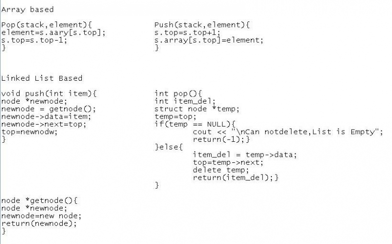

A stack is a list of elements in which an element may be inserted or deleted only at one end called top of the stack. There are two basic operations used in stacks. Insertion of elements into stack is called as Push and Removal of elements from the stack is called as Pop. Stack can be implemented in both Arrays and Linked lists. Stacks follow the LIFO structure that means we insert an element through an open end one after other. This way the element first inserted will be at the bottom and the element inserted at the end will be at the top. Similarly removing an element also depends on the position of the element in the stack. The element at the bottom of the stack requires   that all the elements to be removed first, while the element at the top needs just single operation.
In C++ there are no keywords defined for stack operations. User has to declare functions in order to Push and Pop elements to a stack. Below are sample implementations of pop and push in arrays and linked lists. Hope you understand the code.
