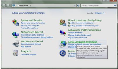

That seems to be an error with the language settings, or the regional settings that you are using on your PC. If you happened to change them by mistake then you will need to retrieve the initial settings:
  • Go to the control panel, and click on Clock, Language and region option from there.
  • Click on it.
  • In the next window, there will be an option for regional and language and another for date and time settings.
  • Change the regional settings to the current region that you are in, and then change the data and time settings too to the proper times and dates of the region that you are in.
  • Restart the computer when you have finished changing the settings and saved them.
Control panel-Clock- Language and region option
That should help return the computer to its normal state.
