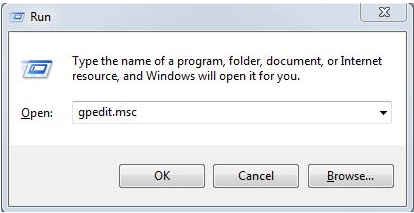

Go to the “Start” > “run” or press “Winkey”+”R”.
Windows Task Managers gets disabled

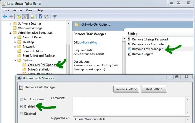

After getting the run box, type “gpedit.msc” on the blank space and press enter. There will be a new tab titled "Group Policy".
Click over there on "User Configuration” > "administrative templates” > "system" click on "Ctrl+alt+Del option” now double click on "remove task manager" on this “Remove Task Manager Properties” tab just select "Enabled ". Now it’s done.

Looks like you have been infected by something. Check the procedure below on how you can restore your Task Manager using the Group Policy Editor. Check first to see if an error will still pop up when displaying the Windows Task Manager by pressing CTRL + ALT + DEL from your keyboard or CTRL + SHIFT + ESC. If an error pops out saying that “Task Manager has been disabled by your administrator”, you will need to run Group Policy Editor to restore the Windows Task Manager.
  • To open Group Policy Editor, click “Start”, then “Run”.
  • Type “gpedit.msc” without the quotes.
  • When the Group Policy window appears, navigate through the drop downs from the left panel on these sections: User Configuration, Administrative Templates, System, Ctrl+Alt+Del Options.
  • Double click “Remove Task Manager” and change the setting to “Not Configured”.
  • Click OK then press CTRL + ALT + DEL to see if you can now raise the Windows Task Manager.

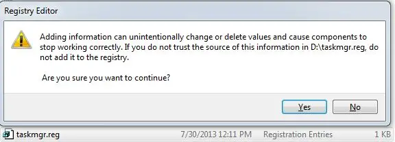

You can also create a registry file [.reg] by opening Notepad and then entering the following:
Windows Registry Editor Version 5.00
[HKEY_CURRENT_USERSoftwareMicrosoftWindowsCurrentVersionPoliciesSystem]
“DisableTaskMgr”=dword:00000000
Save the file as taskmgr.reg then close Notepad. Run the saved “taskmgr.reg” file by double clicking on it then selecting Yes when prompted if you want to add the information to the registry.
Adding information can unintentionally change or delete cause components
