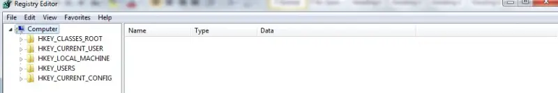

Go to run type regedit.The registry editor will appear as below.
ID software remove the web assistant software

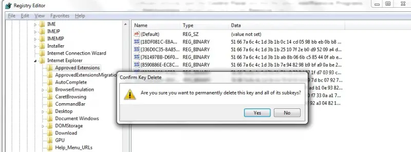

Go to folder HKEY_CURRENT_USERSoftwareMicrosoftInternet ExplorerApproved Extensions and delete the Approved extension folder (right click and select Remove from the dropdown menu).
Registry Editor Confirm Key delete
Now the installation of the ID-card software will complete.
