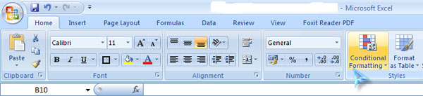

Here is an example of what you want to accomplish. See the table above. To create the table above, you need to use Conditional Formatting in Microsoft Office Excel. First, create the table as shown in the image above. Don’t apply colors on the values under Remarks. The colors will be automatically applied using Conditional Formatting. Once the table is created, click Conditional Formatting under Styles section in Home tab. See image.

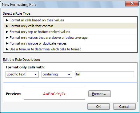

Select New Rule. In New Formatting Rule dialog box under “Select a Rule Type” section, select “Format only cells that contain”. Under “Edit the Rule Description” section, on the first option select Specific Text. On the second option, select “containing”. On the third and last option, enter the text without quotes “pass”. After that, click Format and then select the color green for the font color.

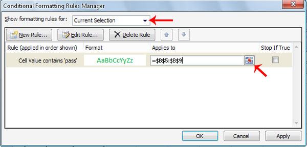

In Conditional Formatting Rules Manager dialog box, select the rule you created. If you don’t see it, select an option in “Show formatting rules for”. Under “Applies to”, click on the small red arrow. After that, select the cells where the values Pass and Fail should appear and then click on the small red arrow again. Click Apply and then OK. See image.
After this, all cells that contain the text “Pass” will have a green color. Again, click Conditional Formatting and then select New Rule. Select “Format only cells that contain”. On the first option, select Specific Text. On the second, select “containing”. On the third option, enter without quotes “fail”. After that, click Format then select the color red for the font color and then click OK all through out.
Click Conditional Formatting and then select Manage Rules. Select the rule with the red color. Click on the small red arrow, select the same cells where Pass and Fail should appear, and then click on the small red arrow again. The two rules you created should have the same range of cells. Click Apply and then OK.
