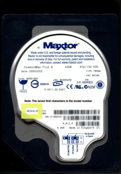

It is the fault of your hard disk which has some corrupted files which are causing this problem. I have also facing the same problems, whenever I put some load to my computer then it turned off automatically. Finally I replaced my hard drive with a new Maxtor hard disk and installed a fresh and registered Windows XP on it and my problem has resolved totally.
I would like to refer you Maxtor hard disk which is reliable and perfect for its amazing quality. You can view its image which I am going to share below:
