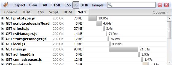

If you use JavaScript too much, your site may reach more than 500 KB of data, and that’s enough to slow down your site. Use gzip for compression, or use the following site:
http://mbcompression.codeplex.com/
As you know, there are many different web browsers. Opening a page normally includes these operations – request, response and sending data. If you use more JavaScript files than your webpage can send, it may cause your page to run slowly. That’s why you have to combine these files together, as shown below.
