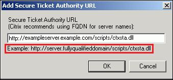

The following are the possible causes of the error that you are getting:
  • The STA URL could be incorrect.
  • The port number may be missing from the STA URL.
In the event that a non-standard XML port is used, the STA URL that is being used should also contain the port number.
To resolve this issue, use the following procedure:
  • When you are doing the configuration of the Web Interface site, you will need to make sure that the STA URL is correct. Use the shown below:
Port number may be missing from the STA URL
  • In the event that you are using a non-standard XML port, then you will need to make sure that the STA URL also contains the port number.
The Connection error message usually displays the computer listing of the client, and the XML port on port 80. But the XML port of the client computer is supposed to be 8080. For that matter, in the event log, the Web Interface will bring a warning message which says that it cannot be able to communicate with the STA server through port 80.
