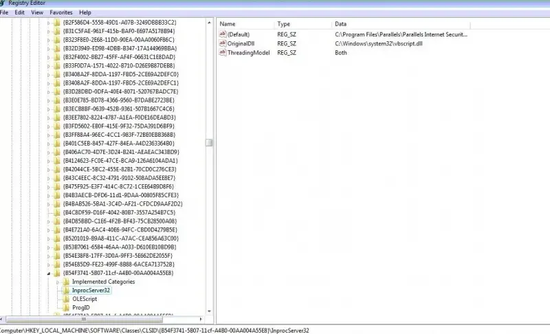

Hi Alfred, your error is most probably due to the installation of your software. You may have installed your software but didn't install some of the direct x or .dll files such as vbscript.dll.
These are the steps you need to follow if that is the case;
  • Try registering the file by going to Start->Run->Type regsvr32
In the window, open C:WindowsSystem32vbscript.dll
If you register the file and it registers properly, a Regsvr32 message will appear stating Dllregisterservice has succeeded
The file should now be able to work.
