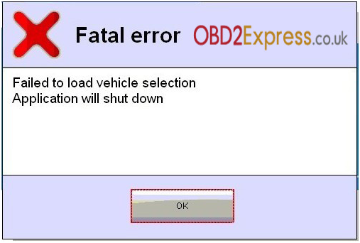

I have a problem with Autocom CDP Pro software. I have installed this software but I cannot open it when I open the software it gives me the following “Fetal error”. Is this the software issue or any thing else. Any help would be appreciated.
Failed to load vehicle selection
Application will shut down

The reason you are getting the "Fatal error" report is because there is a problem in your installation of the software. However, there are a number of solutions that you could take so as to get rid of this problem. In the 2011.3 software, you can install the updates, or you could get rid of the files by deleting them. You can get more information at
http://eobd21.overblog.com/tag/autocom%20cdp%20pro/
Answered By 590495 points N/A #328410
Autocom CDP Pro software does not open
If you keep receiving fatal errors with your program, check the system requirements again and verify that your computer meets those requirements. If this is not the problem or there’s no problem with compatibility, try to uninstall and reinstall. Download the free version of Revo Uninstaller and install. Once installed, start Revo then select the affected program among the applications and click “Uninstall.”
Follow the normal uninstall process. When uninstall is complete, click “Scan” to scan your computer for any leftover files and click to delete everything it finds. This removes everything the program created on your computer. When it is finished, exit Revo then install the program back. If you haven’t updated yet, try checking for an update and install the updated version.
If you are using a trial, check and verify that the trial period has not expired. If the trial period is over, either uninstall the program or buy it or buy a license. Try also downloading a new trial version if there is any.
