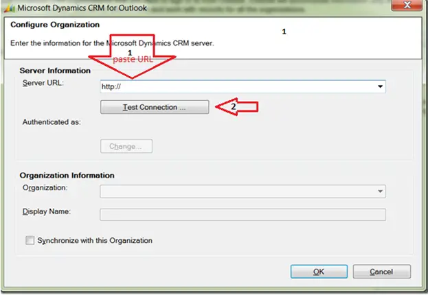

This might be an issue with credentials. Please make sure that the credentials are correct by logging in to the web-client, in order to test the credentials. If you are able to login to web-client successfully, then continue with the steps below:
  • Open your web-browser & login to Microsoft CRM
  • Copy the full URL from address bar
  • Run the CRM configuration wizard from Start > All Programs > Microsoft Dynamics CRM 2011
  • Do not change the server URL to CRM Online. Paste the full URL (copied from browser address bar) to your CRM Online environment to the “Server URL” field, then click “Test Connection” and enter your CRM Online credentials.
Ideally, this should resolve the problem. Incase if it does not, and then check for Windows Live Essentials beta, Windows Live Essentials 2011 or Windows Live Sign-in Assistant being installed in your computer as there might be some unusual conflicts between processes.
If you find Windows Live Essentials Beta, being installed then go ahead & uninstall it or upgrade to Windows Live Essentials 2011. Then try to run the configuration wizard again.
If you see Windows Live Sign-in Assistant or Windows Live Essentials 2011 already installed, then run a repair & try to run the configuration wizard again.
