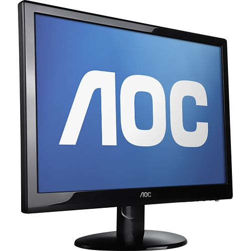

I finally arranged a home office in my apartment, thus having to move my desktop from the living room to the new space (short distance, no bumps). I obviously had to disconnect everything, and reassemble the computer-monitor-printer workstation again. The problem is that the monitor is not working. I know I plugged in all correctly (I even have each slot and cable labelled). The computer starts with no problem, but the only response from my monitor is the tiny power LED indicator. What could the problem be? What could I have done wrong, when the setting is exactly the same?
