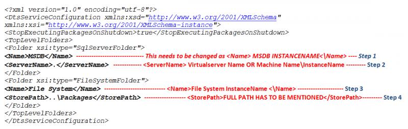

Well, the answer to this problem  is to use a file name as “MsDtsSrvr.ini.xml” which we can find in this location “%ProgramFiles%Microsoft SQL Server<90><100>DTSBinn”. If you open that file then it will look like this:
Here then is connection to the local machine will be used  i.e. name of the server. So keep in mind this vital information. So you have to specify SQL Server name Instance Name like <ServerName> SQL Server NameInstanceName </ServerName> OR If you installed SQL Server Cluster then it should look like <ServerName> SQL Server Virtual Server InstanceName</ServerName>.
We need absolutely some changes for each one which are specified in red in the image above, so keep that in mind because it’s very important.
