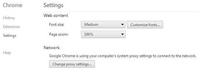

Go to settings > options> Under the hood> Proxy settings (Under network menu)
Internet Properties will open, then select Connections and after that selecting LAN settings unselect all.

It seems you have not configured the proxy settings in the browser properly, and therefore you will need to configure them. Follow the procedure below:
  • With Google chrome opened, click on the settings icon in the top right corner of the browser.
  • Choose options.
  • Click on 'Under the Hood'.
  • In the window that will open, click on 'change proxy settings'.
  • Change the proxy settings accordingly to suit the settings that you are using on the network that you are on, in case you are not using proxies on that network then remove the settings that may be configured.
