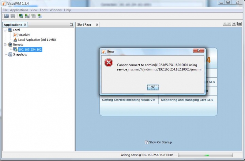

I have problems with VisualVM 1.3.4. It says cannot connect to admin. My connection is fine, and firewall is set too.
What could be the problem with this?
VisualVM 1.3.4
Error
Cannot connect to admin @192.165.254.162:100001 using service:jmx:mi///jndi/rmi:/192.165.254.162:100001/jmxrmi
Thanks,
Christopher

Hello Chris,
The error you're getting is possibly due to a JDK bug taking heap dump which is crashing the target JVM in case it is running JDK 6 Update 16+ using Concurrent Mark Sweep garbage collector (CMS).
To resolve that issue, you will need to use a different GC , for instance -XX:+UseParallelGC. The same issue may affect the JDK 7 devbuilds.
