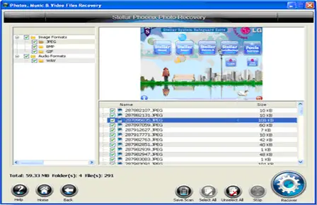

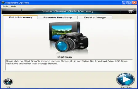

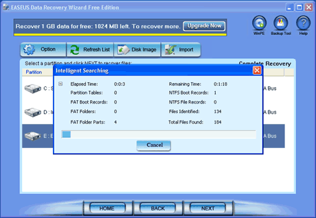

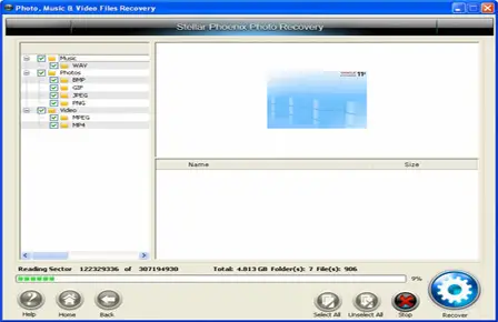

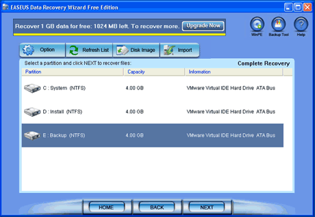

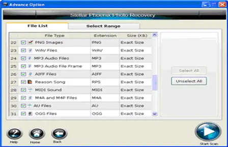

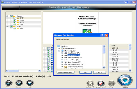

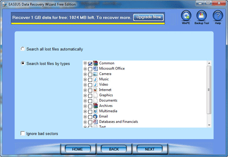

Your system's slave hard drive has failed because of some storage related issues. Your son's pictures and videos can be reloaded as they are still there in the slave drive. For restoring your son's pictures and videos, use a reliable Hard drive data recovery software utilities or any disk recovery tools. Here are some useful links:
Digital media recovery from stellarinfo
Stellarinfo presents windows data recovery
Data recovery wizard from Easeus
When running your data recovery software, make sure you use them as the Administrator. Do not panic, try checking the task manager to see the ongoing processes, this may help you locate some files operating from the slave drive. If not, then open Run window; type recent and press enter to see the files and folders that you have opened. From these, look for a file that was in that slave file and right click on it and go to properties, collect the location and navigate to it and/or try to run the recovery file by putting in that location. Then your data will be recovered. Follow the recovery methods of your recovery software and your data will be restored. Next time, remember to always keep backups. If the problem is still not solved, contact an IT expert near your area.
