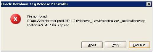

I am installing Oracle Database 11G release 2  on my system from drive D: there is an error while in the process of installation. This error keeps on going on even if I keep on repeating the process from the start, and both time and effort is wasted.
My wild idea on this problem is focused on the image file I created would have some error reading, when the installation process attempts to extract the file it can't read the file or whether the installer ran out of space, I am not sure of my wild guesses.
Please somebody help me qualify my wild ideas in solving this error message.
I am showing below the description of the error I encountered.
Oracle Database 11g Release 2 Installer
File not found
D:appAdministrotorproduct11.2.0dbhome_1owbexternaloc4j-applicationsapplicationsWFMLRSVCApp.ear
Please help.

Hello Mark_fassy, you are trying to install Oracle 11g release 2 it is a big software and its size near about 2GB. Now you did not mentioned some information like your PC configuration and from where you got the installer?
At first you see, you have some files missing, so you better do not try to install it again from that source. You can download the Oracle 11g latest version from Oracles website and you may need to open a free account. Then you can download two files of Oracle database. Unzip them is the same folder and then try to install it from that folder. I don’t think you can get the missing file separately. And from my experience whenever I got some message or warning, Oracle 11g did not installed correctly and cause so much problem. So you better check your PC configuration. If configuration is ok then start installing form a fresh copy of installer.
Hope these suggestions work for you.
