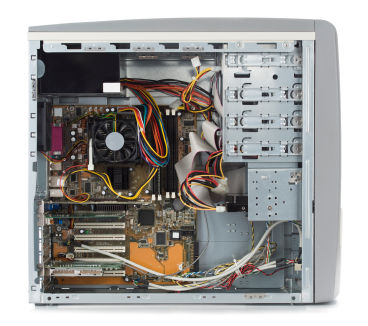

I just want to set up a good cooling system for my desktop computer because I usually it for 12 hours everyday for my home-based work and leisure when I play online games.
Any suggestions on how to have a good air flow inside my computer tower.
I currently have these kind of fan setup as shown below:

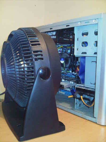

I have a simple and easy way on how to have a good airflow inside your system unit just in case if you don't have money to burn. All you have the need to do is to open the case of your system unit.
And after that is to put the electric fan beside your system unit just what my attachment shown. Also make sure that the cables inside your system unit are less crowded and well arrange so that you will have a better cooling performance.
Hope it helps you.
