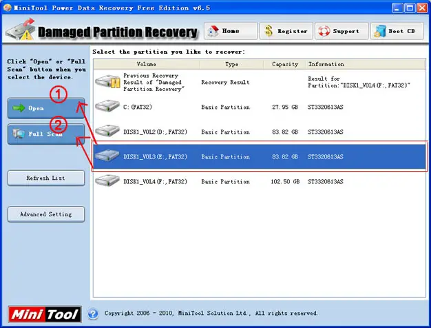

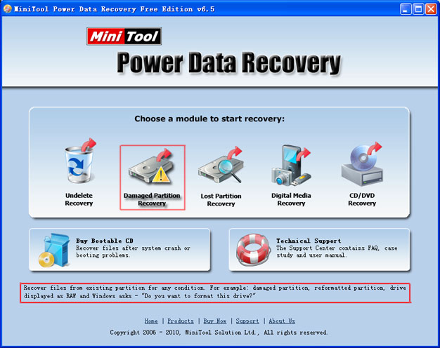

Try to download this software and see if it will help you. "Mini Tool Power Data Recovery". This is due to its ability to search damaged or lost partition, yet to recover data from damaged partition swiftly. Download and run Mini Tool Power Data Recovery, then click "Damaged Partition Recovery" module to perform damaged partition recovery. Below follow the steps and I hope u will succeeds:
Click "Lost Partition Recovery", user may see:

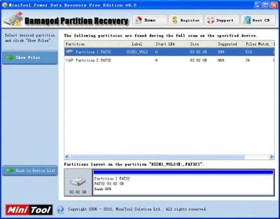

Under Damaged Partition system, if partition could normally recognize software and be displayed in the partition list, user should select this partition (E), and then click "Open" on the right function menu bar. Open function is able to load data of not severely damaged partition, normally. Otherwise, please select "Full Scan" which is capable of restructuring and displaying any partition conditions on the basis of remaining partition data information before it was damaged. Similarly, user could recover lost partition with this module if disk partition is badly damaged.
By using "Full Scan", existing partitions can be searched and restructured, yet matching partition could also be searched according to information of lost partition. Then click "Show Files" to preview data information on this partition:
User could check files to be recovered and save them into assigned location. Thus, Mini Tool Power Data Recovery has successfully recovered data from damaged partition.
