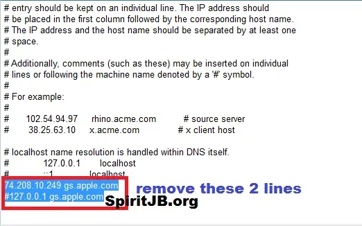

The error you are getting could be occurring because iTunes is not able to talk to the Apple signing servers. To resolve that issue, you will need to do the following:
  • You will need to correct date, time as well time zone settings.
  • You will need to ensure that you have administrative credentials.
  • You will need to get the latest version of iTunes and install it to replace the older version you may be having.
  • Make sure the OS that you are using has the latest updates installed.
  • If there is any problem with proxy settings you will need to correct them.
