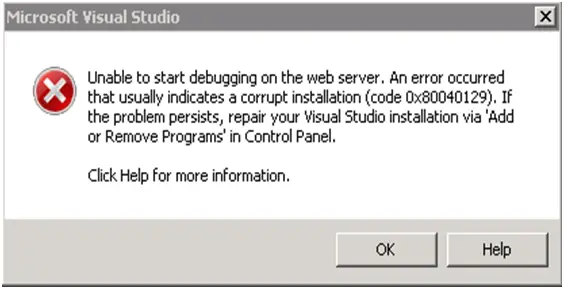

Error message shown in Visual studio 2010
I have an application program for farm solution using the Visual Studio 2010 which is a C# SP 2010 Event Viewer. In the program, it’s a List Item Event and the event source in which, the events are added, updated, and deleted in a regular basis. Why that happened to my Visual studio 2010? Is it ok if I will just get another reinstallation? When I tried executing the debugger mode, a pop-up error appeared. According to the error message, reinstallation is required.
Microsoft Visual Studio
Unable to start debugging on the web server. An error occurred
that usually indicates a corrupt installation (code 0x80040129). If
the problem persists, repair your Visual Studio installation via 'Add
or Remove Programs' in Control Panel.
Click Help for more information.
                                                                                   OK               Help
Why is this happening? I need help for this.
Thank you.
Answered By 0 points N/A #138166
I think it's an 64 bit issue. This message appears when you try to debug an ASP.NET application on a 64 bit OS. So, what to do? Configure your application pool to run a 32 bit working process.
Now do it: Check the advanced setting for your application pool and set 'Enable 32-bit application' to 'False'
Click 'Ok"
I think your problem has been solved.
